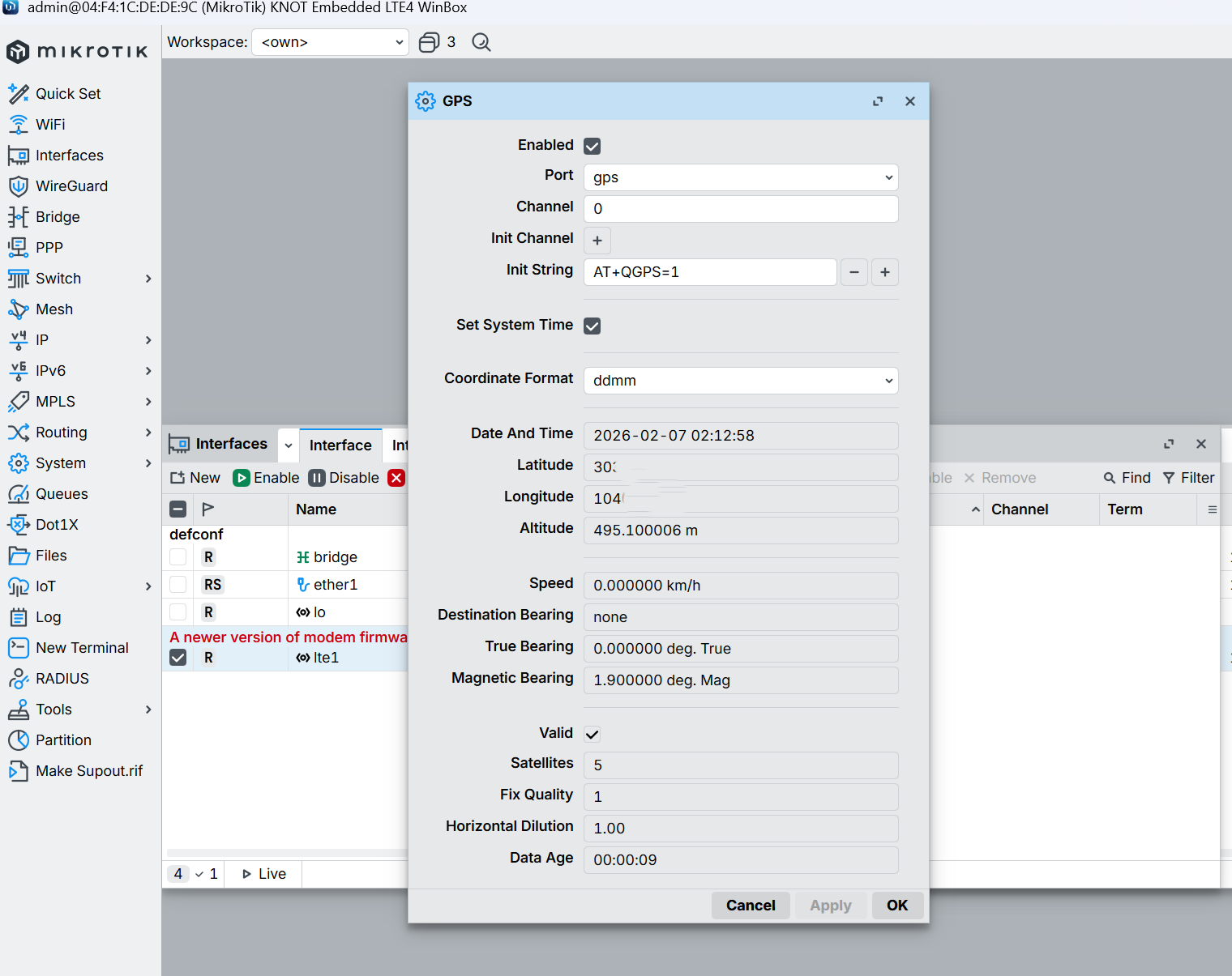

⚠️ 要求RouterOS支持gps安装包,访问/system/gps,卫星定位需要在户外空旷地域使用,至少需要连接3颗卫星。特别提醒 室内无法连接卫星!
关于如何配置 RouterOS 的 GPS 可以 参考

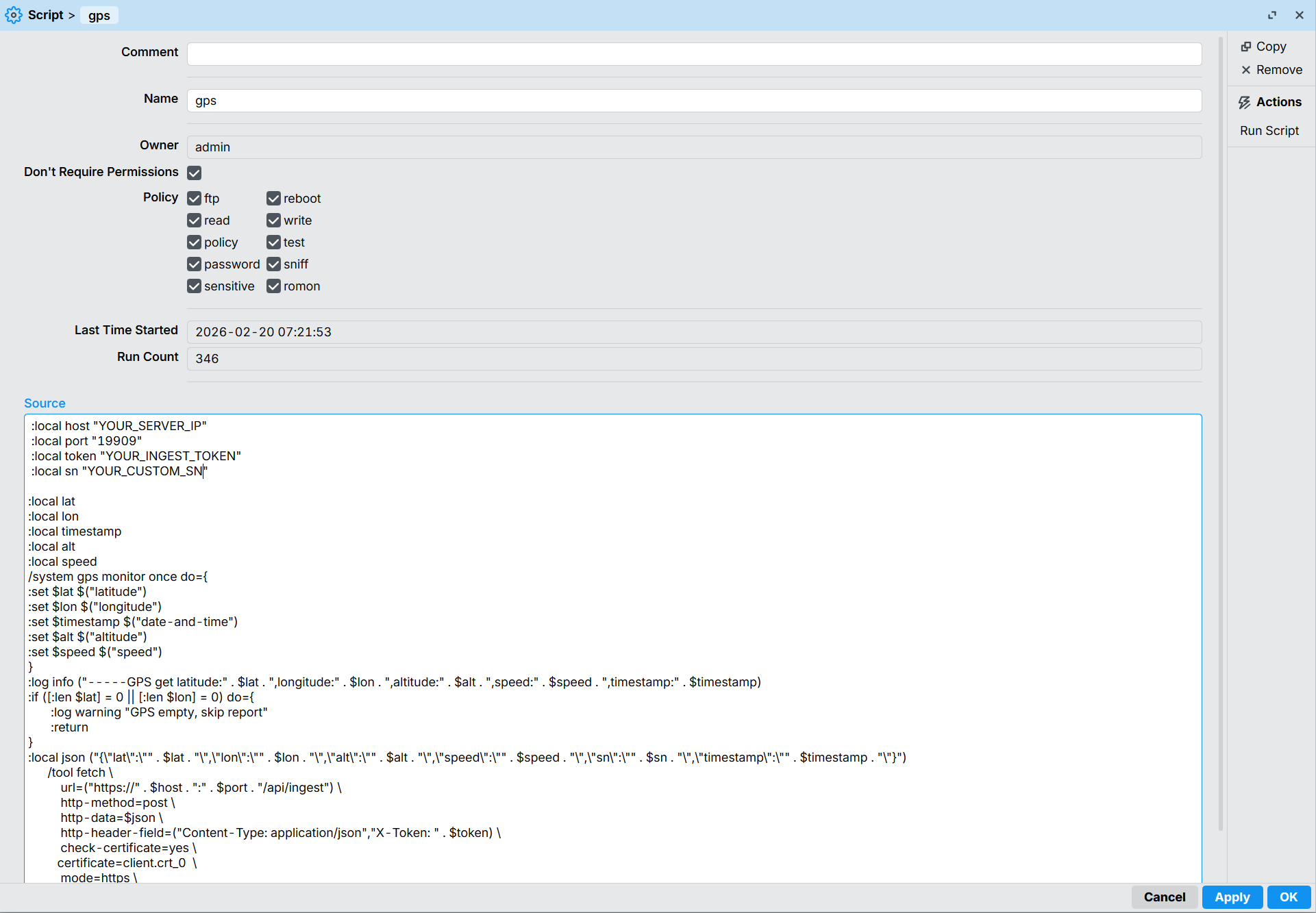

RouterOS 脚本:
 :local host "YOUR_SERVER_IP"
 :local port "19909"
 :local token "YOUR_INGEST_TOKEN"
 :local sn "YOUR_CUSTOM_SN"
:local lat
:local lon
:local timestamp
:local alt
:local speed
/system gps monitor once do={
:set $lat $("latitude")
:set $lon $("longitude")
:set $timestamp $("date-and-time")
:set $alt $("altitude")
:set $speed $("speed")
:log info ("-----GPS get latitude:" . $lat . ",longitude:" . $lon . ",altitude:" . $alt . ",speed:" . $speed . ",timestamp:" . $timestamp)
:if ([:len $lat] = 0 || [:len $lon] = 0) do={
       :log warning "GPS empty, skip report"
       :return
:local json ("{\"lat\":\"" . $lat . "\",\"lon\":\"" . $lon . "\",\"alt\":\"" . $alt . "\",\"speed\":\"" . $speed . "\",\"sn\":\"" . $sn . "\",\"timestamp\":\"" . $timestamp . "\"}")
      /tool fetch \
          url=("https://" . $host . ":" . $port . "/api/ingest") \
          http-method=post \
          http-data=$json \
          http-header-field=("Content-Type: application/json","X-Token: " . $token) \
          check-certificate=yes \
         certificate=client.crt_0  \
          mode=https \
          output=none
 :log info ("GPS reported OK!")

进入 /system/script 创建gps脚本,将上面的代码写入

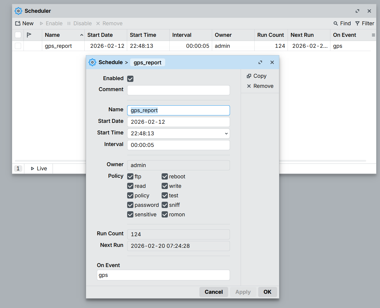

进入 /system/scheduler 创建计划任务,每5秒上报一次GPS信息
